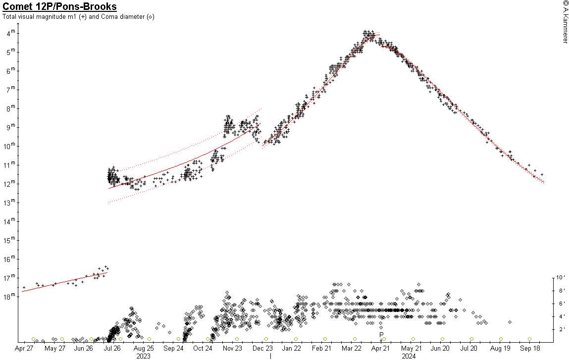

Moving weighted 3-days-means of Total Magnitude, Coma Diameter and Degree of Condensation
Based on 690 observations by 76 observers the average brightness development can be represented quite well using the following parameters:
t < -275d: m0 = 11.0 mag / n = 2
t > -275d: m0 =  5.2 mag / n = 2.7
If the comet follows this development, it would reach a peak brightness of 5.5 mag ±1 mag around Apr. 21, 2024 (perihelion passage). It reached magnitude 7.5 in the first week of February 2024.
The development of coma diameter and degree of condensation also reflect the outburst behavior. Shortly after an outburst the highest DC values were reached (up to DC 8-9), which decreased rapidly during the following days. The coma diameter increased noticeably during the days following the outburst until the outer parts of the expanding coma reached the surface brightness of the sky background. Shortly afterwards the next outburst occurred with an initially small coma displaying a high surface brightness, which expanded over the following days (while the surface brightness decreased). So far the maximum coma diameter of 8' was observed as a result of the largest outburst (in July) in mid-September 2023, indicating an absolute diameter of 1.1 mio. km. In each of the following eruptions, both the apparent and absolute diameter did not reach these values. A tail has been observed since the end of August 2023. It reached a length of 15' (5 mio. km) on CCD images at the beginning of February 2024. During this period the tail changed its orientation from Southeast over East to NNW.
