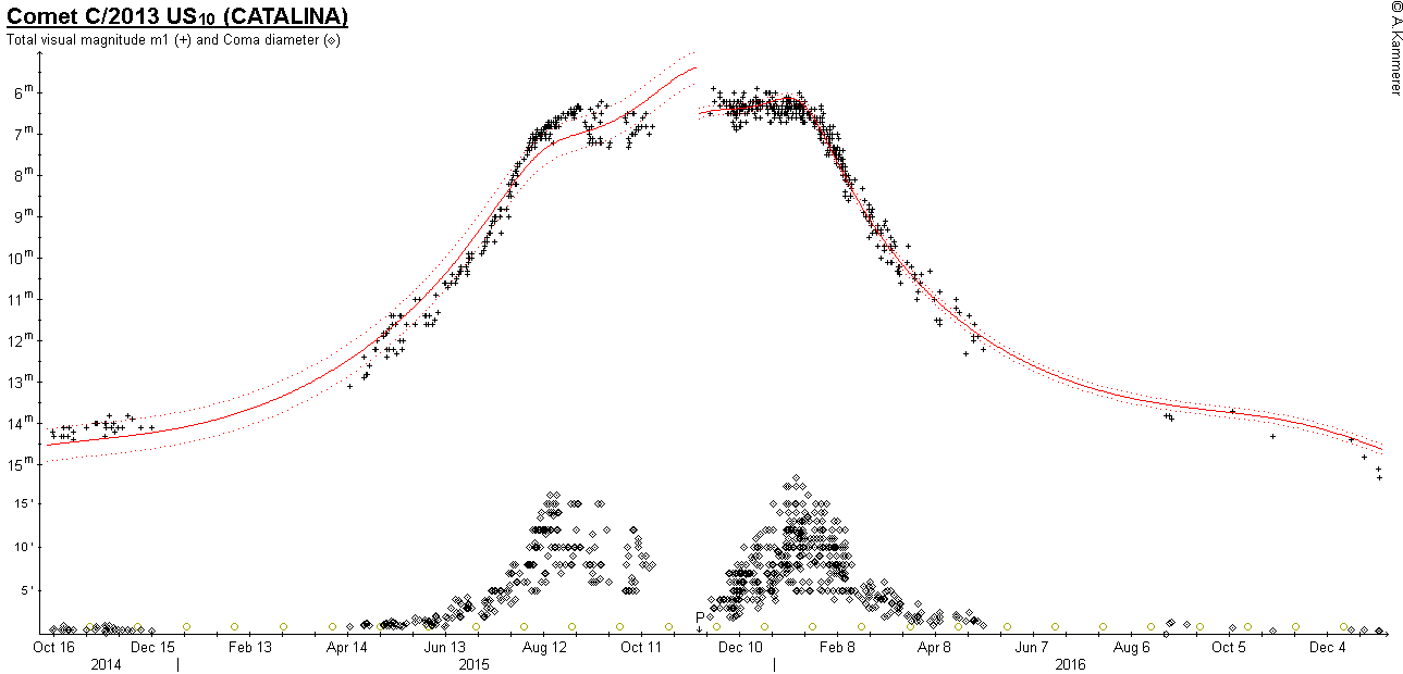

This comet was - without doubt - the most interesting cometary object in winter 2015/16. Thus it is no surprise that 103 observations from 11 members of the German Comet Section and 700 international observations could be used for the analysis. Pre-perihelion the brightness estimates can't be well represented by one standard formula. On the other hand, the width of the confidence band allows only marginally a division in distinct phases. Nevertheless, it is obvious, that the estimates are consistently too faint - in comparison with the formula - between early May and early July (difference in early July: +0.5 mag), but too bright thereafter, with the difference reaching -0.6 mag in early September. During the last weeks before conjunction with the Sun the estimates are too faint again (early October: +0.6 mag), which can only partly be explained with the then deteriorating observing conditions. Furthermore the post-perihelion brightness estimates are consistently fainter, compared to the pre-perihelion formula. So far, post-perihelion the comet shows a steady brightness evolution. The maximum brightness of 6.2 mag was reached around Jan. 12, 2016. At the end of the first week of April 2016 the comet had faded to 11.0 mag. The corresponding brightness formulae are as follows:
pre-perihelion: m = 4.9 mag + 5×log D + 8.8×log r
post-perihelion: m = 5.9 mag + 5×log D + 7.2×log r
The apparent coma diameter started to increase rapidly in May 2015. Then only 1' it reached a first maximum of 14' in mid-August, with this value remaining constant until mid-September. Nearing its conjunction with the Sun it decreased systematically, reaching 7' in mid-October. At its reoccurrence it showed a compact coma of diameter 4'. Approaching Earth the apparent coma diameter increased rapidly, reaching a maximum of 17' when closest to Earth (0.725 AU on Jan. 17, 2016), only to decrease immediately thereafter, measuring short of 4' in mid-March and 1.5' at the start of May. In absolute dimensions the coma began to expand significantly in May 2015, swallowing from 160.000 km to 800.000 km at the end of September (rapid increase until August, getting slower thereafter). After the reappearance it measured only 200.000 km (a result of the then strong solar wind), expanding rapidly during the following weeks, reaching a second maximum of 550.000 km in mid-January 2016. This value remained constant until mid-February, thereafter decreasing to 350.000 km until mid-March and to 250.000 km in early May. Between April and July 2015 the degree of condensation increased from DC 4 to DC 5-6. Then, surprisingly, a longer period followed during which the coma got steadily more diffuse, reaching DC 3-4 in September (despite a higher-than-average activity). Thereafter the coma got more condensed again, reaching DC 5 when it disappeared. Post-perihelion the degree of condensation was DC 5-6 at first, decreasing constantly to DC 1-2 until the beginning of May. Post-perihelion the coma showed a false nucleus, which was prominent at first, but still pronounced thereafter, reaching a brightness of about 11.0-11.5 mag.
Total Brightness and Coma Diameter (standard time scale)
