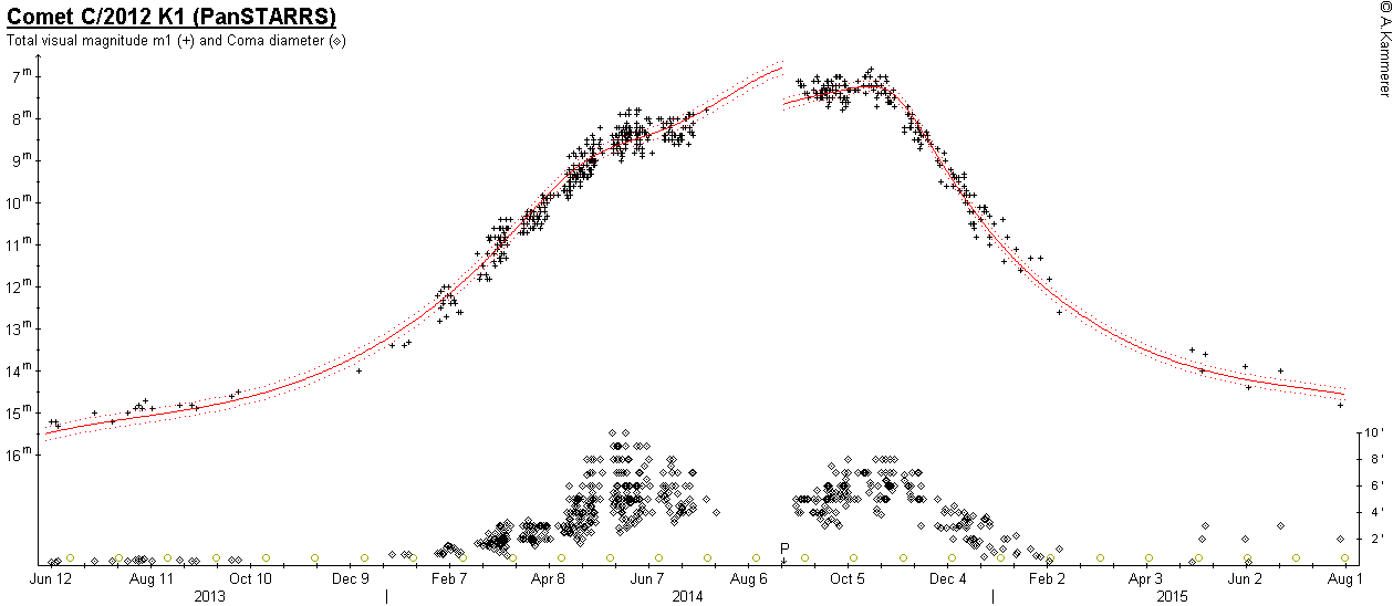

For the analysis 131 observations by 10 members of the German Comet Section and 515 international observations could be used. These indicate an average activity parameter of the comet, however, the absolute magnitude was 1 mag fainter after perihelion compared to the time prior to perihelion. The appropriate formulae are:
pre-perihelion: m = 5.1 mag + 5×log D + 9.4×log r
post-perihelion: m = 6.0 mag + 5×log D + 8.6×log r
Due to the fact that the comet was unobservable between the opening of July and the end of August the observed maximum brightness was magnitude 7.2 around Oct. 20, 2014.
Total Brightness and Coma Diameter (standard time scale)
Total Brightness and Coma Diameter (compressed time scale)
In 2013 the coma diameter increased only marginally from 0.3' to 0.8'. During the following months it increased more rapidly, reaching 9' in mid-May 2014, where it remained until the comet disappeared in the twilight. Post-perihelion the apparent coma diameter increased from 4.5' to 7.5' between the start of September and Oct. 20. The absolute coma diameter increased slowly in 2013 from 50.000 km to 120.000 km. At the start of 2014 it increased much faster, reaching 650.000 km at the end of May. The increase of the apparent coma diameter after perihelion is the result of the decreasing distance comet-Earth (until mid-October). Actually the coma decreased during this period from 375.000 km to 325.000 km, reaching 150.000 km by January 2015. Until Nov. 2014 the coma showed a noteworthy constant degree of condensation of DC 5, then decreasing to DC 3 until January. Within the central part of the coma a rather conspicuous central condensation could be observed.
