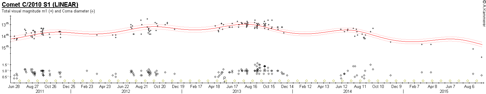

The evolution of this comet can be derived from 43 observations by 5 members of the German Comet Section and 140 international observations, spanning more than 3 years of coverage (July 2011 to Sep. 2014). These indicate an extremely slow brightness evolution, best described by time-dependent parameters, distinguishing the periods prior and past perihelion. Pre-perihelion the parameters are m0=9.3 mag / nt=0.0005, post-perihelion m0=9.3 mag / nt=0.0010, yielding the following maxima: Nov./Dez. 2011: 13.6 mag, Sep. 2012: 13.2 mag, Aug. 2013: 12.9 mag, July 2014: 13.4 mag.
The comet shows a miniscule coma, fluctuating between 0.6' and 0.8' in accordance to the changing distance to earth. This implies a rather constant coma diameter between 225.000 km and 250.000 km during the whole apparition. The degree of condensation declined continuously during the apparition, measuring DC 6 in 2011, but only DC 3-4 in 2014. Visual sightings of the tail (not exceeding 2') required large instruments and have only been reported during summer/fall 2013.
Total Brightness and Coma Diameter (standard time scale)
Total Brightness and Coma Diameter (compressed time scale)
